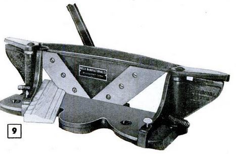

From January 1959 Popular Mechanics
Dosch Mfg. Co. was established in 1906 or a bit earlier to manufacture tools: a miter box, a patternmaker's hammer, a floor scraper, a lathe tool. None of these are of interest to this Vintage Machinery website.
In 1958 the company introduced a universal miter trimmer that had been patented in 1900 by Peter Dosch of Mount Vernon, NY, and subsequently manufactured by a firm started by Peter Dosch, the Lion Machine Co. Peter was apparently committed to a mental institution in 1929 and the Lion Machine Co. was taken over by relatives. Some kind of intra-family dispute occurred and as a result the Pootatuck Corp. also manufactured the miter trimmer. We do not know how the Dosch Mfg. Co. is related to Peter Dosch, nor what connections there may be to Lion and/or Pootatuck.
