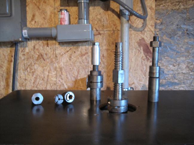

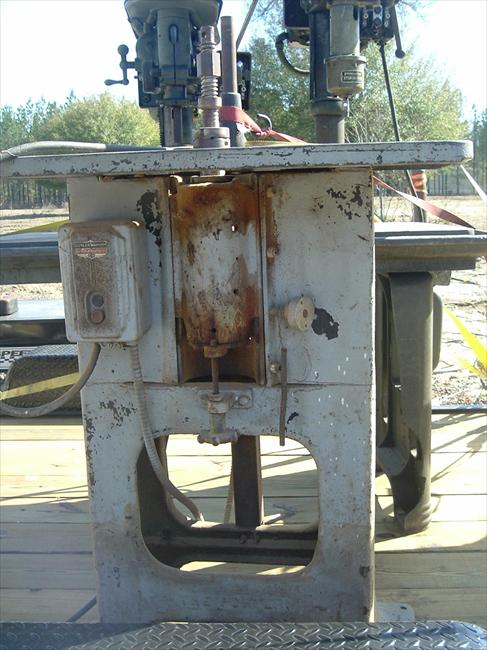

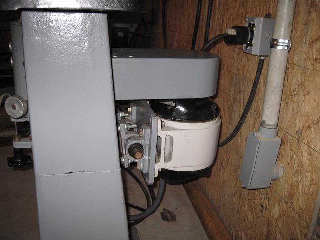

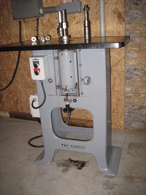

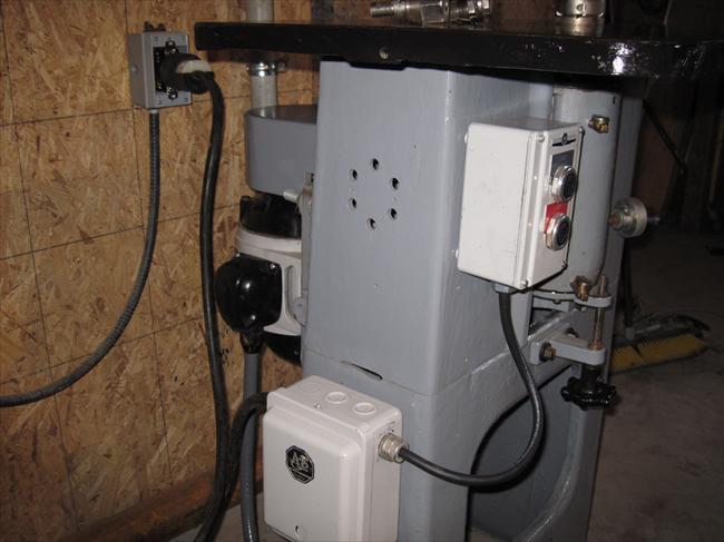

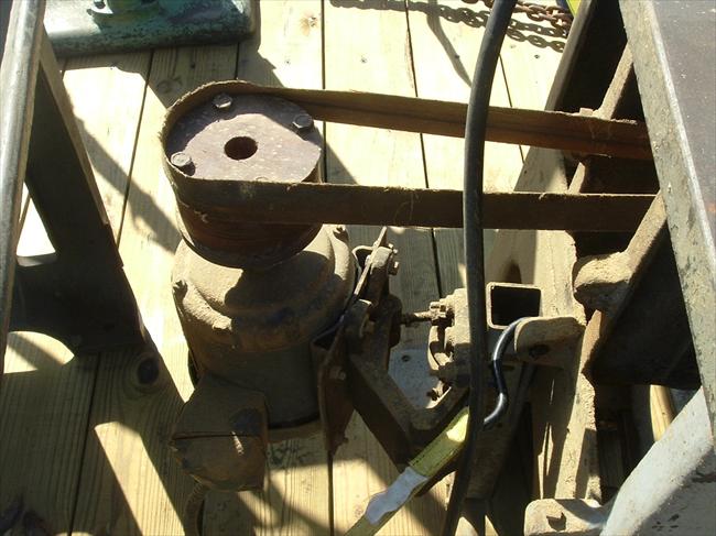

I picked up the shaper in early 2007 from a local pattern shop, It had a crudely installed 1.5 hp motor. It came with 3 spindles, 1/2" 3/4" and 1". It also had 3 router collets. I fabricated a Motor mount and Belt guard and installed a 3 hp US Electric motor. There are a couple of these machines listed on thesite and are listed as #5 shapers. This one has no ID marks on it. It has the number 186 stamped in the table and I am assuming this is the serial#. The spindle is set up to operate at 9200 RPM. My guess is the shaper weighs in a little over 400#
The spindle on this shaper looks to be identical to the Moak#7 shaper. There is also a picture posted on the site of an early model Moak that looks identical to this shaper.
Shaper in place
Before picture
spindles and collets
New motor mount and belt guard
old motor mount
Left side shot
