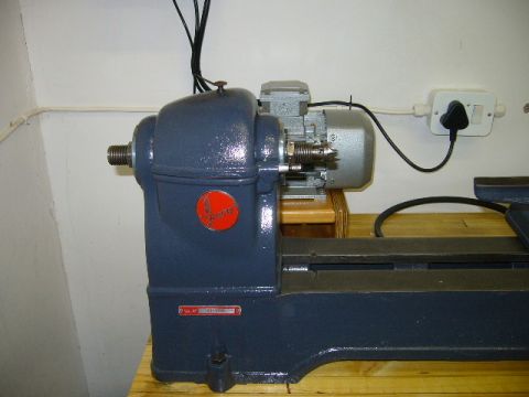

Been looking for a while for a lathe. Found this in the local machine dealer. Strippedand painted. Paint may be a bit dark as I used left over paint from my tractor. Made new bench top. Wired up with a VFD and 3ph motor. Very smooth and the speed control makes life a lot easier.

Headstock with new 3ph motor
My Pana
