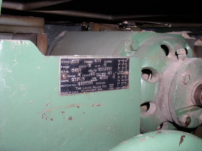

saw with a 5 HP motor and 1-1/8” Arbor and a Surty Guard. The 4 in the phase
box is a mispunch. It obviously should be a 3. It sold originally for $1,081.25

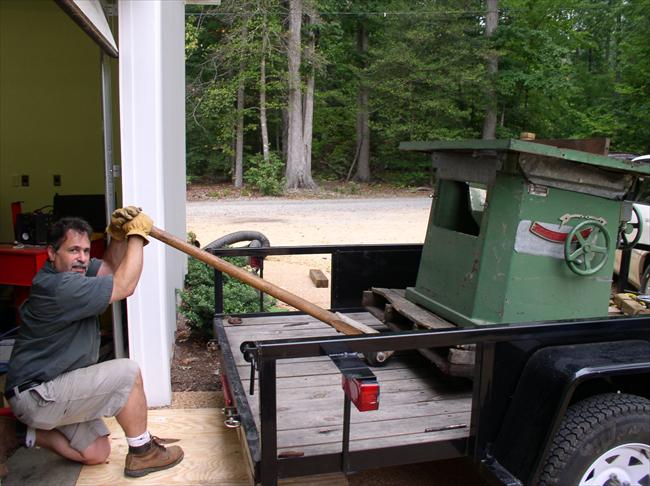

Lifting the pallet to place pipe rollers

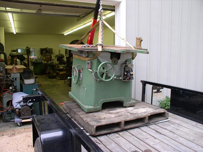

Saw rolled to rear of trailer, engine hoist makes the lift

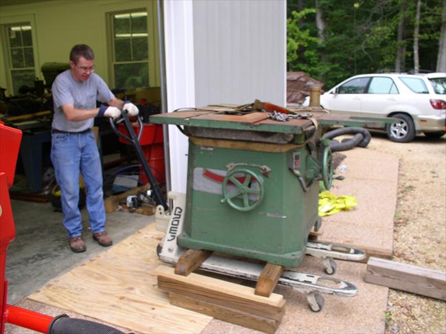

Saw transferred to pallet jack

Something's wrong with this tag...
