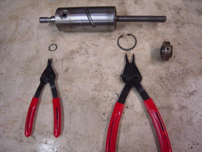

The shaper is basically in great shape. Only some minor rust on the stand. The pulley had become loose at one time and slightly chewed the end of the spindle. That will be fixed next. The plug was an old style three prong for an A/C unit. I replaced the plug with the two horizontal blade type. Then I ran a 240V line into the shop and powered it up. It runs well in both directions.

Comments: Bearing replacement
Comments: Replacing damaged and worn die-cast spindle pulley with one made of iron
