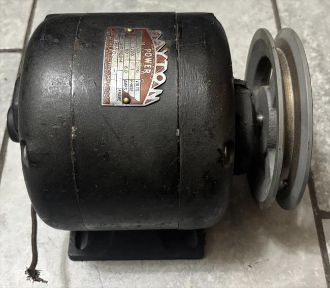

Came across the motor on eBay. Probably paid too much but, I couldn’t resist. Not much information on it but it got narrowed down to be from the late 30’s pre-war, pre-Grainger machine. With a little more information found the true manufacturer to be Reynolds Electric Co
As found

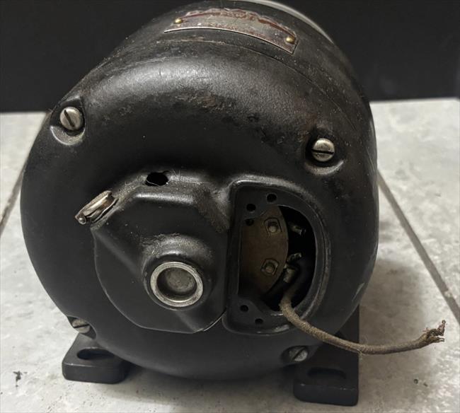

Missing cover but, motor is in overall good condition

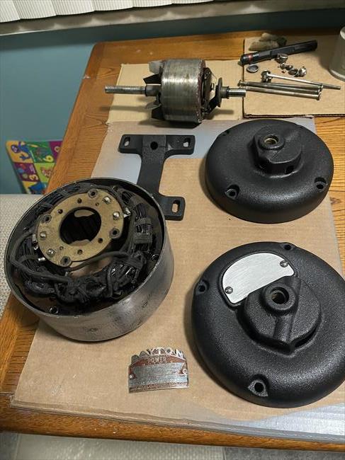

Started restoration, painted end castings and made a new access cover

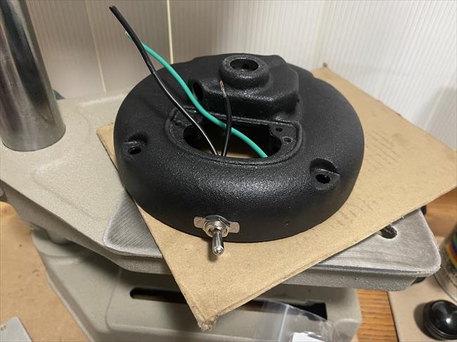

Added a ground and a switch

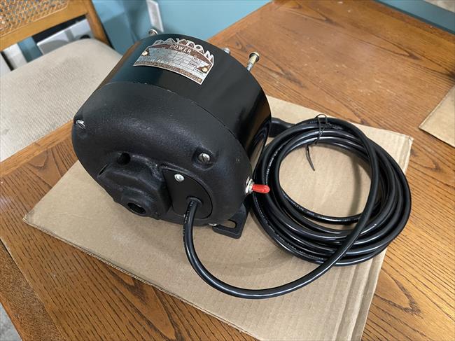

Gloss black paint for the winding body and a 15’ cord

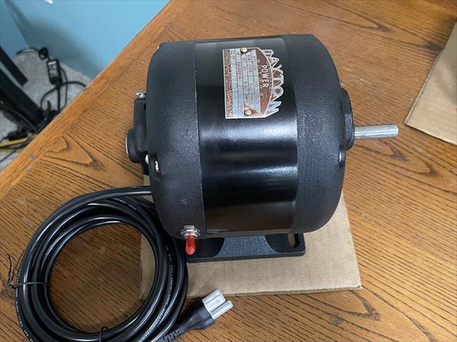

Finished. Made new oil reservoir applicators. Other than it being fairly heavy it’s a very nice motor that runs smooth, quiet and strong.
