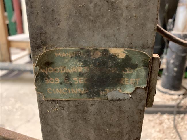

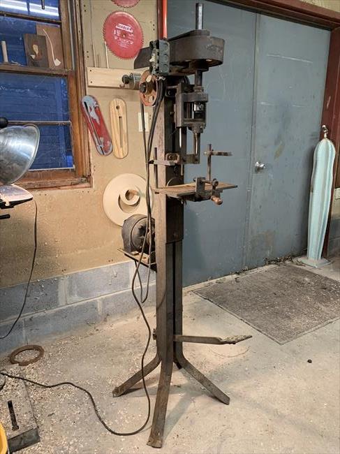

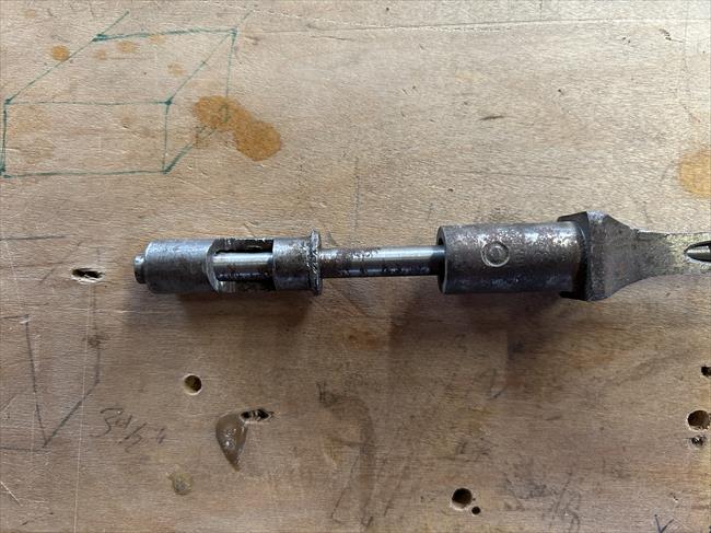

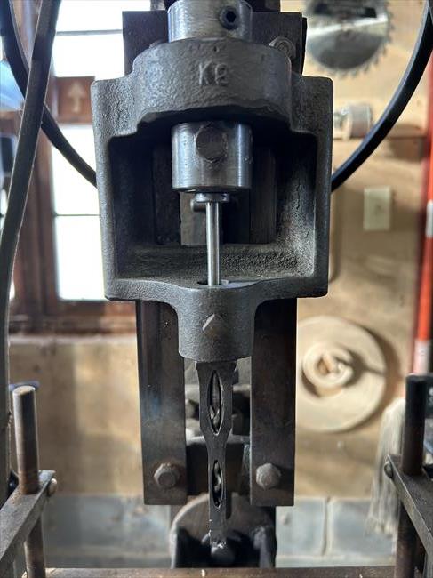

Bought in Cortland, NY for $75. The sticker on the side says "MANUFACTURED BY WOODWARD MACH CO 309 E. SECOND STREET, CINCINNATI OHIO" but admin pointed me to Woodworkers Tool Works. I cant find any other maker's marks on the machine. Motor brace says "THLEHEM" which is assume to be Bethlehem steel. Chuck is 1/2" bore, collar/set pin style, each collar drilled out to snugly fit an auger shank. I got a couple collars which look like they're homemade from clevis pins. Chisel shank size is 5/8". Motor is 1/4hp Westinghouse, not sure how old.

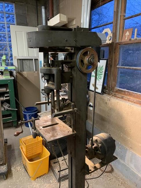

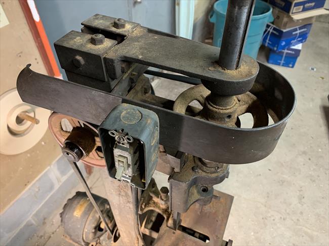

I disassembled, stripped, and repainted. Added new closed bearings. Motor cleaned, wired with new leads and grounded, also reversed the motor rotation and turned it up more like a modern drill press. Added a homemade left/right table and clamp. Works great.
