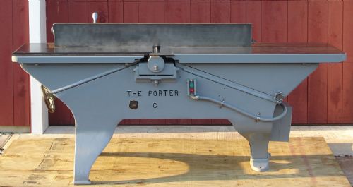

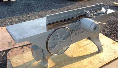

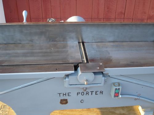

Porter 16" direct drive jointer. This machine was 550 Volt when I bought it. I had the motor rewound to 220 Volt. I also replaced the bearings. I stayed with oil bath type bearings. This jointer is complete with no breaks or repairs. I'm only missing the cutterhead guard (although I do have the bracket). It has a 4 HP, 3450 RPM motor. The cutterhead is a 4 knife. I also added a new starter and push button control.
