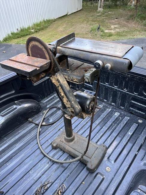

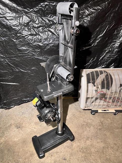

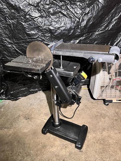

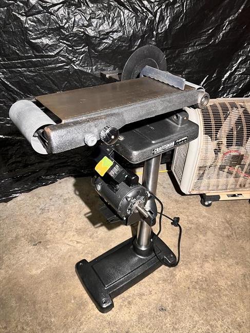

My wife and I picked up this sander in Warsaw MO. The motor didn't work but it was an easy rebuild and cleaning of the motor and a new capacitor did the trick. It had some heavy rust so I had to do quite a bit of cleaning and rust removal. Some parts needed painting and others just got a touch up. It came with the belt cover. I picked up another belt sander in Hot Springs AR. It's in bad shape but some parts are good. I'm cleaning up the table from that sander as an add-on to the belt side, so it will have two tables. I also got what I believe is an original wrench and after cleaning that up it has become quite useful. I think it is 1/2 inch on one end and 7/16 on the other. The Power switch is from a Craftsman router table I had at one time. The original power switch was a light switch design. I used the original screw holes and fabricated a metal mounting panel to attach the new switch. I like it. I finally got to use it and it works great.
Belt sander restore complete. Added the second table and the belt adjusted well. I'm looking for the right kind of glue and paper for the disk

Belt Sander Before
