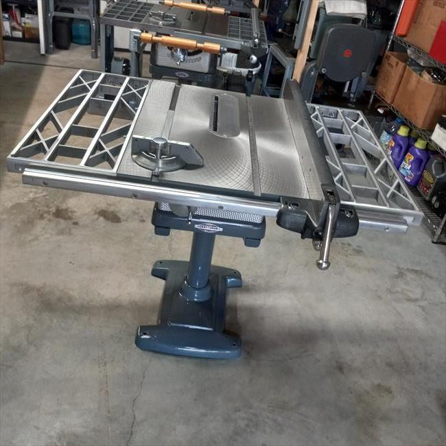

This Craftsman 10-inch Model "100" Bench Saw was bought brand new in 1956 by my Cousin Bob at the Lincoln Park Michigan Sears store where he worked at in Sales in their Hardware Department. I inherited his saw after he passed away at almost 92 in 2017 from his Daughter. I remember seeing his table saw at his house out in Howell Michigan since I was in grade school. Cousin Bob was a real Carpenter Contractor and lugged this table saw all over Livingston County and SE Michigan when he bought it new while living in Taylor Michigan.

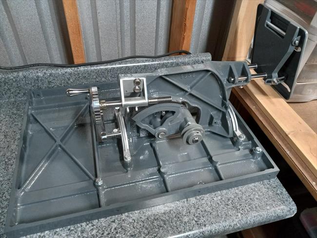

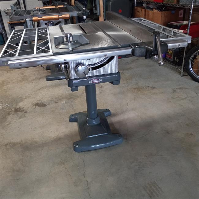

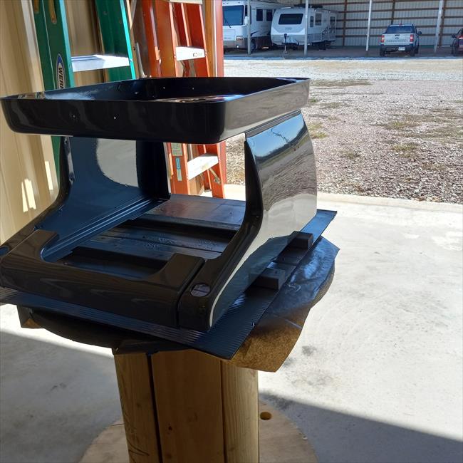

The saw was all painted in the Awl Grip two-part polyester paint system. I had the table top "Blanchard ground" flat like the Emerson factory did back in 1956 up Madison Heights, MI at Panka Tool.The side cast aluminum extensions I had on hand off my 1966 Craftsman Emerson made "Floor Model" 10-inch cabinet saw that I shipped to Cousin Bob from Houston in the summer of 2002. In 1956, Cousin Bob just purchased the Model 100 bench saw only, no extension wings, motor or factory metal stand. I replaced the original arbor shaft bearings and bought new machined steel belt pulleys using a new red Fenner link belt. I used many new stainless steel and some new zinc plated fasteners on the saw. The front cover panel was so badly weathered I glass beaded down the old engine turning aluminum panel and used a 3M brandrd vinyl engine turned self adhesive sheet product. I swapped out better condition chromed handles I had on hand to replace all the very badly pitted original ones. I'm going to use a vintage Arrow-Hart "Snap Switch" I'm restoring now with all new 14 gauge power cord wiring. The motor I'm restoring for this saw right now is a 1-HP TEFC Craftsman/Packard Electric made 115.version that my Cousin bought brand new in late 1958 at his Sears store also. He used some used under powered motor he had on hand or was given for two years before buying a brand new 1-HP TEFC Craftsman motor that is date stamped 9/58.
The heavy cast semi-steel rip fence and front aluminum fence rail are repurposed off my 1966 Craftsman Floor Model cabinet saw which is one hell of a heavy duty SMOOTH UPGRADE over the original style rip fence that was not bad at all. The original "Craftsman Power Tools" cast in the top miter gauge is the original 1956 miter gauge. I also still have the original Emerson made cast Zamac metal rip fence. The thin aluminum blade throat plate is the restored original one that screws down very securely. Right now I am running a vintage teflon coated Systi-matic Bandits 55-tooth combination blade. The original machine badges were cleaned with 3M Finesse-it and then clear coated in Awl Grip.

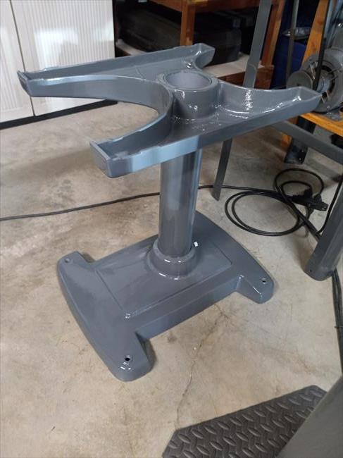

I found the Craftsman pedestal stand off FB Marketplace in the Fort Smith Arkansas area in August 2024 with a 1955 Model 100 table saw for $60. I restored the pedestal stand and also kept the heavy duty 115. 1-HP Craftsman motor and also it had one original cast iron extension wing. This saw was at a local furniture manufacturing company in Mansfield, AR that was a family run business for over 100 years. Since 1955 this local family furniture business only used two Craftsman Model 100 10-inch table saws in their lumber cutting operations that the Owner/Grandfather bought brand new in Fort Smith at the Sears Store. Says a hell of a LOT about the functional integrity of these 10-inch Emerson made Craftsman Model 100 table saws! They were an exclusive furniture contractor manufacture for the Econo Lodge Motel chain for many years per the Grandson who sold me the table saw.

Front View 1956 Craftsman Model 100 TS on pedestal stand
C. Garrett Android Phone
Blanchard Ground table top view
C. Garrett
Restored under table view
C. Garrett
