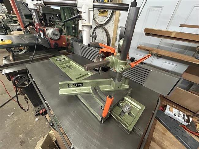

Table adjusts for angled tenons

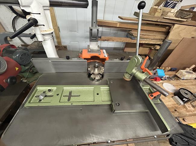

Bolted to my Northfield shaper with multiuse cutter

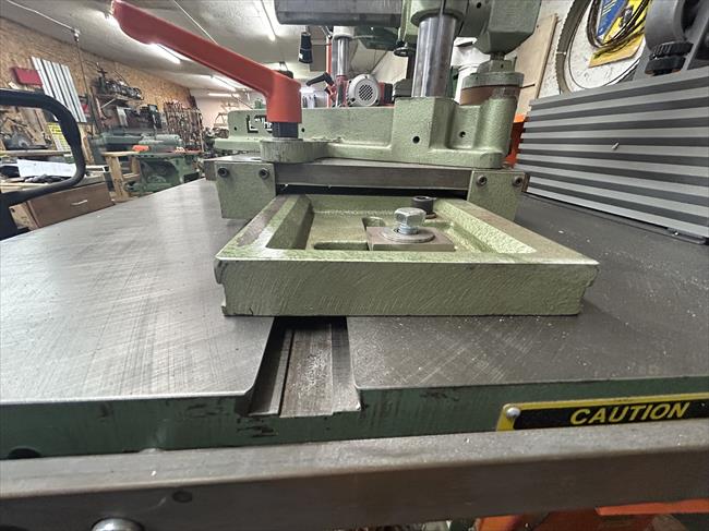

Top half rides on ball bearings in grooves of the fixed bottom portion.

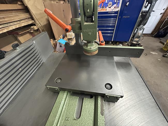

Eccentric hold down clamp
