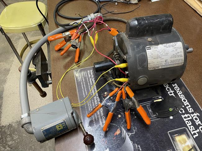

March 2024:
Test run with reversing switches.
Connections with Craftsman 2982/Furnas A14 to MOTOR:
A – T5, 1 – open, 2 – REV LEAD, B – LINE (black), 3 – T1, 4 – REV LEAD, LINE (white) – T4
Connections with Craftsman 2018/Furnas R4C to MOTOR:
1 – REV LEAD, 2 – LINE (white) & T1, 3 – T5, 4 – REV LEAD, 5 – T4, 6 – LINE (black)

Test run with reversing switch.
