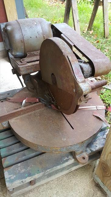

I acquired this saw many years ago, and finally rebuilt it recently. Cleaned up nice, runs nice, cuts true. Table rides on hundreds of individual ballbearings that fill a cast iron trough in the base casting. There is an extremely tight tolerance between the base casting and table.

Tanny miter pre-rehab
