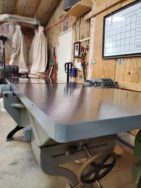

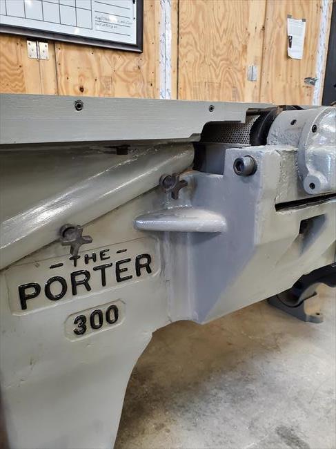

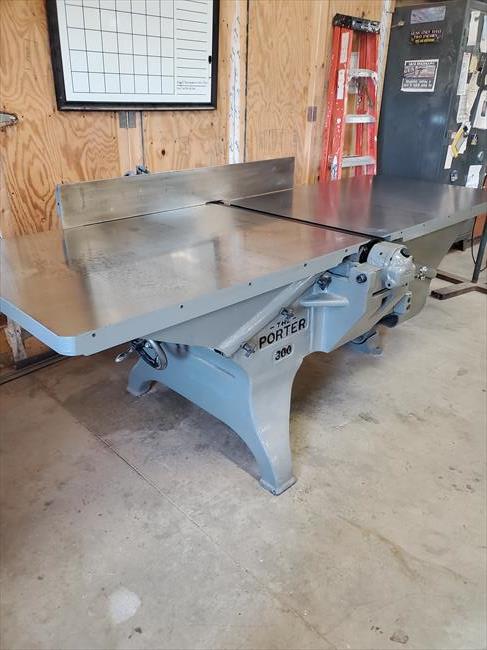

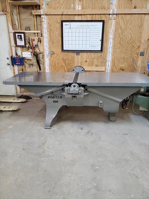

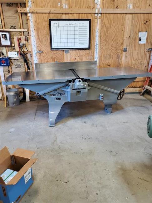

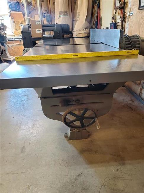

This is the largest jointer I've ever seen so well restored missing motor plate, according to the overloads in the motor starter I believe it to be 15Hp. I ohmed out the windings of the motor it is wired Delta which produces higher starting torque. Hope to obtain more info on this awesome machine
