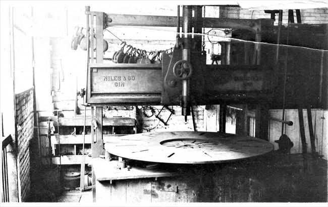

This is a photo of a Niles & Co. Vertical Boring Mill made in the mid 1850's
At that time Niles called them Horizontal Face Plate Lathes.

The picture was taken by Fred Colvin of the American Machinist Magazine.

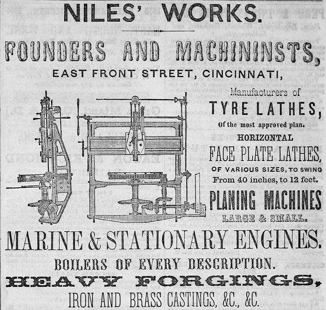

Shown below is an 1855 ad for the machine.
