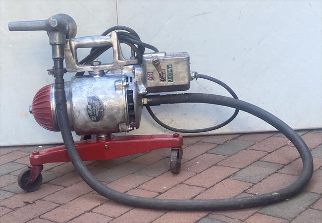

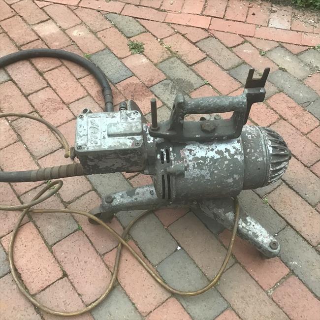

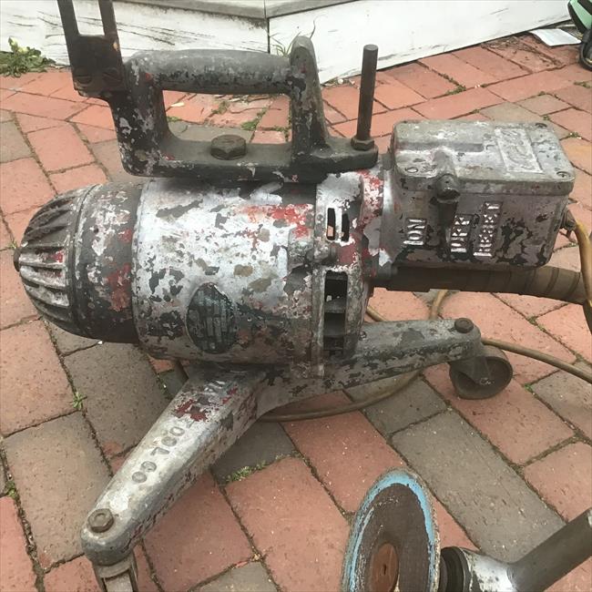

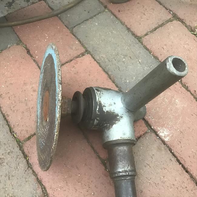

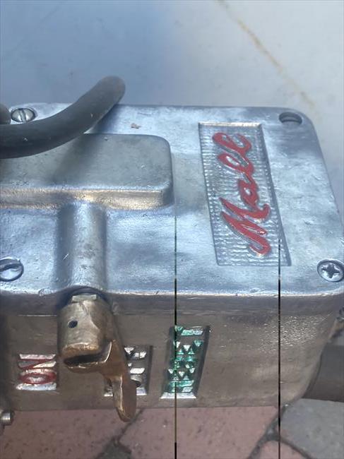

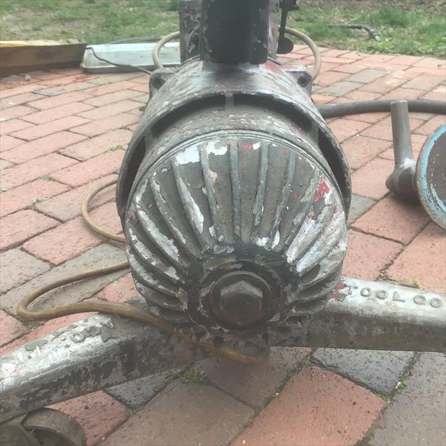

Bought from fellow in central NH. His dad had a body shop, and they used this in the business. This is a very heavy duty flex shaft grinder. 1 hp TEFC motor, with water proof, explosion proof switch. Weighs in at 120 lb. Adapted from Mall’s line of Terrazzo grinders. Can be fitted with water-line grinding head for surfacing concrete/ limestone masonry. This 3450 rpm machine can be fitted with grinding wheels, or sanding discs up to 7”. Really could use a disc guard.
Three years later!
