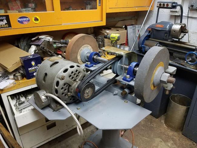

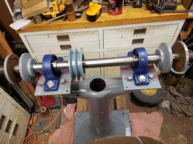

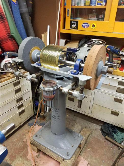

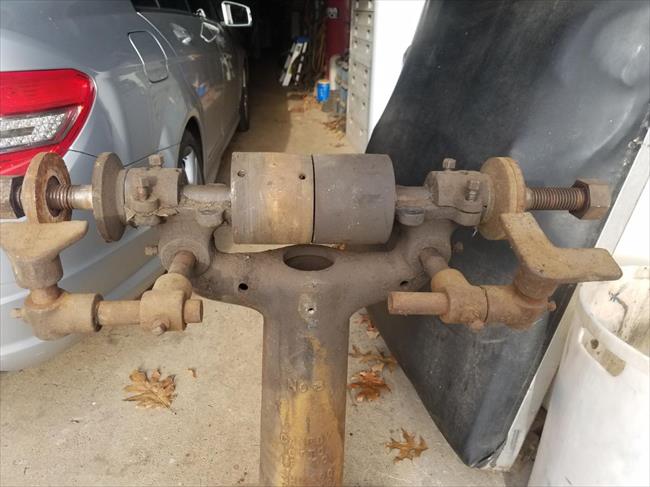

Picked up a Canedy-Otto #3 Pedestal Grinder from Craigslist for next to nothing. Haven't been able to find any info about it other than one vintage ad dated 1922. Plan to make some modern improvements to make it useable. The flat pulley will be replaced by a v-belt pulley, the Babbitt bearings will be replaced by pillow blocks, guards will be fabricated and an electric motor installed (just like another that I did). Plan to use 12" wheels. Will be a nice useable machine when I am done
As purchased
Old line shaft machine

With electric motor
12 wheels
Modifications - V-belt pulley replaced flat belt pulley and pillow blocks replaced Babbitt bearings.
