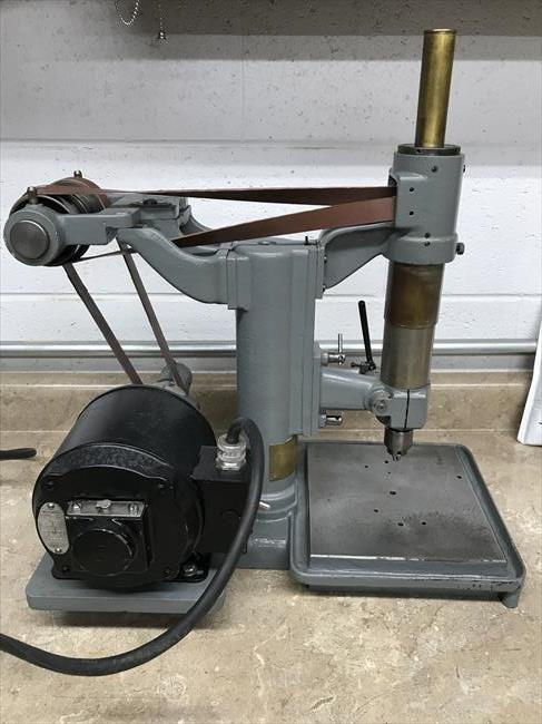

The Sigourney Tool Co “No. 0 All Ball Bearing Sensitive Drilling Machine”, Hartford, Connecticut, sold by Pratt and Whitney, casting code S-2-28 - likely made in 1928

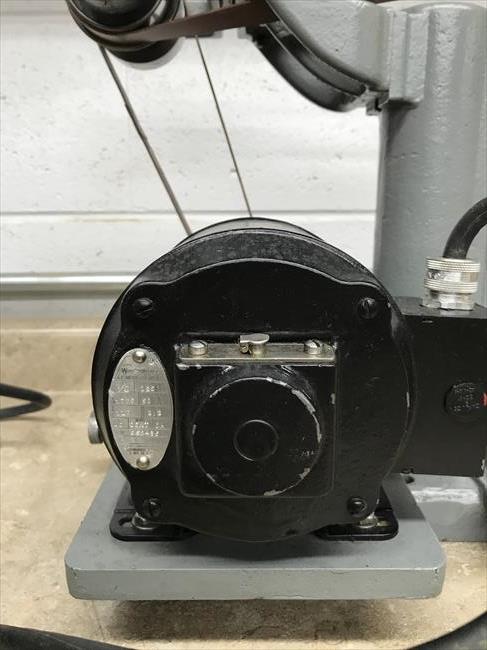

Westinghouse 1725 RPM, 120V, 2.2A, 1/8 HP, three pulley speeds 4800, 7500, 10,000 RPM at the 1/4” No. A chuck. Quill travel is 1-1/4 inches.
Acquired from Landis+Gyr Metering in mid-1990s. Originally purchased by Duncan Metering of Lafayette, Indiana for the manufacturing of electric watthour meters.
Repainted, installed new bearings, and new belts over 20 years.
Drill press from right side

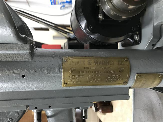

Distributor Pratt & Whitney

Westinghouse motor plate
