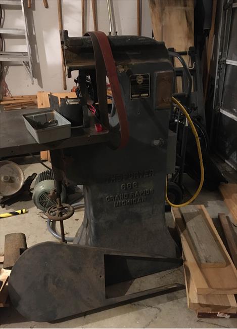

Bought from a machinist near Bloomington IL. He had used it to machine aluminum parts. Bearings need to be replaced, collet holder re-ground, and new belt. Also has a much newer 3hp 3ph motor. Very solid machine.

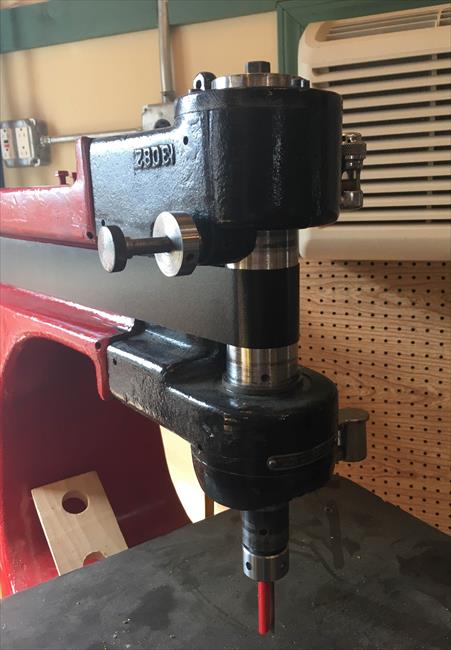

Note that the proper belt on this is a very thin belt, akin to a couple of pieces of duct tape stuck face to face. This had a roughly 1/8" thick rubber belt when I got it, and replaced it with the same, but that belt would not track.

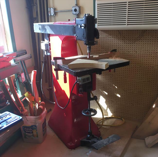

As restored now
My camera
Unloaded in my garage. Spindle assembly removed for rebuild and motor removed for transport.

Spindle with belt, guard removed.
My camera

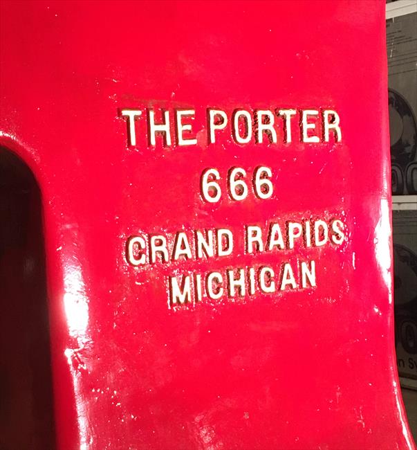

A bit of bling
My camera

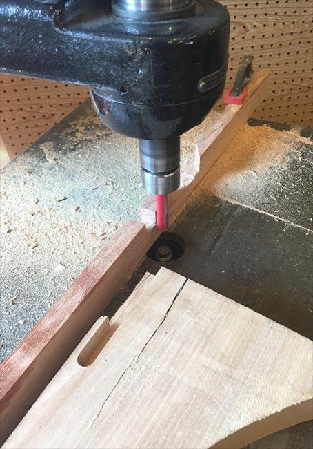

Action shot
My camera
