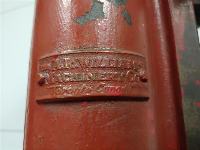

Only identification on the drill is the A.R. Williams cast brass tag. I believe they were only the dealer and the machine was made by W.P. Davis as it is identical to another drill press attributed to them here.

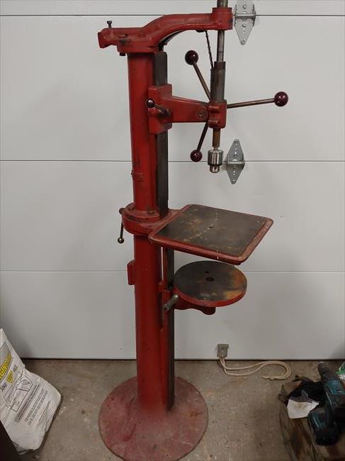

Drill has 14" capacity when using square table, but only a 12" capacity if using the round table. Square table measures 13" x 13" overall, while round table is 10" in diameter.
Square table able to be swung completely around the column, while round table rides up and down on a machined dovetailed ways.
Overall a really neat drill. I am glad I decided to grab it, even though I dont need it.
Complete Drill

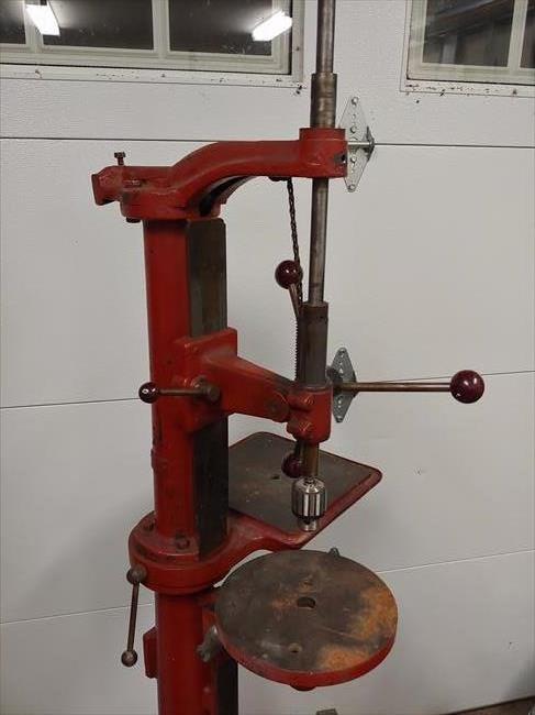

Head with square table swung out of the way

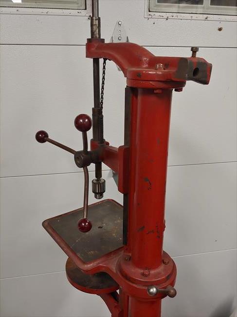

Rear view, showing cut off stubs of original drive mounts.

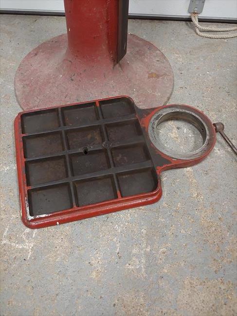

Under side of square table - measures 13" x 13" to outside of coolant trough

A.R. Williams Cast Brass tag. Located on side of upper main column casting.

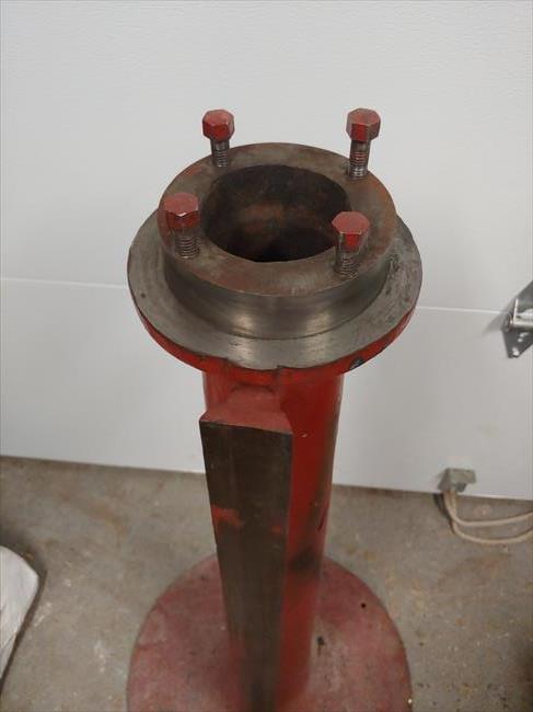

Top of lower main pedestal casting. Square table mounts and swings around round machined area while upper column bolts on top.
