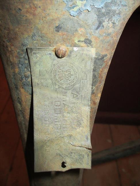

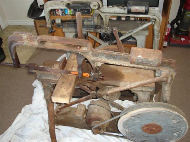

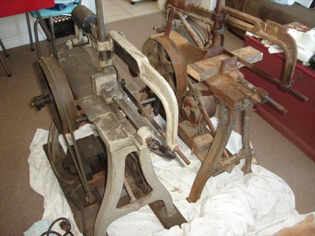

I acquired two of these machines from a business that upgraded to a bandsaw. One was branded with "D. McKenzie Machinery" and the other "A.R. Williams", whose makers tags were riveted onto the adjustable cast iron weight. Both were identical except the A.R. Williams unit had "Williams" cast into the saw arm. Both were adapted to electric motor with v-flat drive instead of lineshaft flat belts.
I had to use the parts from one to make the other complete and working. It's still being used occasionally but I have to make a new drive shaft as the current one is worn down where it runs in the cast iron frame (no bearings)
