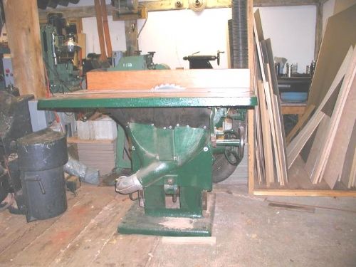

As is the case with many table saws, there is a lot of open space under the table for dust to escape from. I made a rubber gusset which is screwed to the underside of the table and the outside of the blade housing.It is made from thick butyl rubber so I'm not worried about it getting near the blade. It greatly increases the effectiveness of the dust collector.

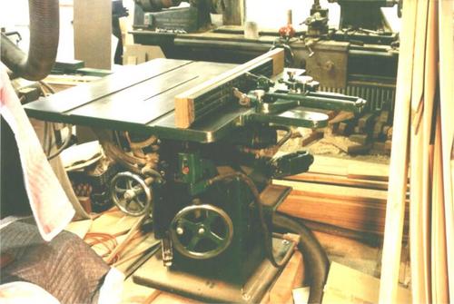

Tannewitz direct drive table saw

Side view showing sawdust chute and rubber dust gusset

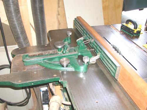

Fence with tilting provision. The locating pins were missing so I made new ones. Note the checkering in the table surface.

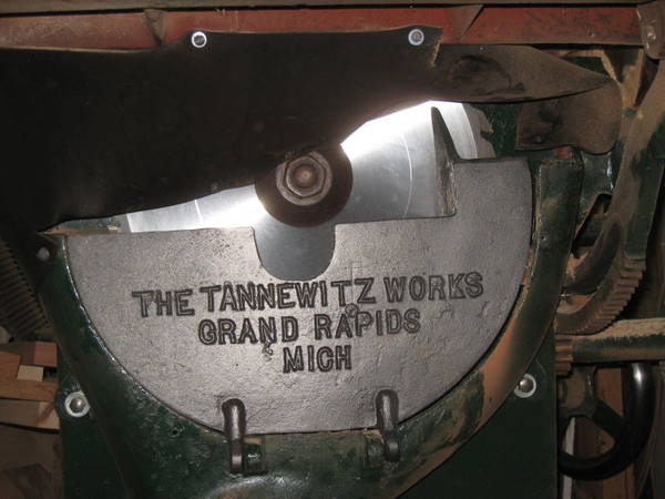

New dust door cast by Cattail foundry. Original borrowed from Mike Wiggins

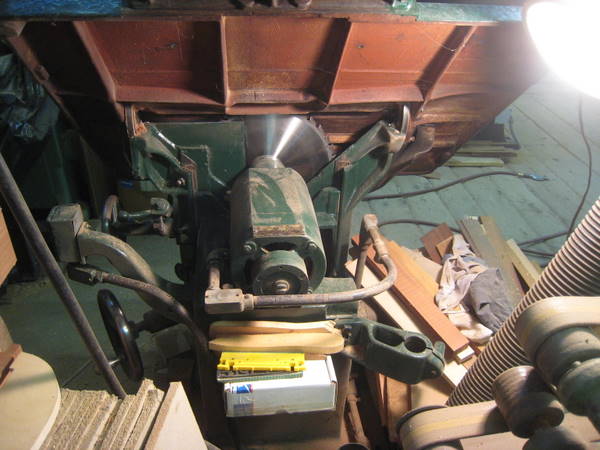

Table tilted to show Louis Allis 5 hp motor

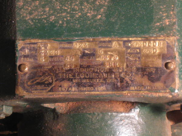

Motor tag
