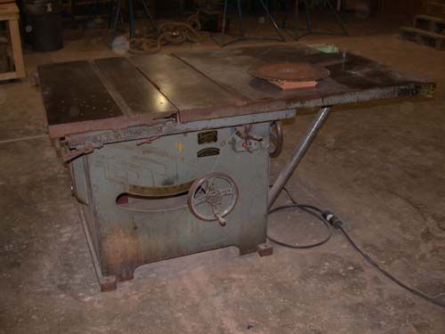

XJ was the top-of-the-line Model variety saw for Tannewitz. As far as I know the XJSW was the largest saw available from them with a single arbor. XJ is the Model designation, S designates 'sliding', and W for wide table extention. This can be determined by the heavy supports, welded tubular on U & XJ, cast on the J models.
This saw was purchased in a lot from a furniture factory in North Carolina for $50. Originally a 550 volt machine w/ Cutler Hammer starter, motor was rewound 220/440 three phase and new Furnas magnetic starter added to make operational.

Saw was missing some of the accesories, but included an arbor brake and handle bracket for sliding table. Currently equipped with a Biesmeyer fence system as the original was long gone. Some of the 'sliding' models did not come with a rack & pinion fence.
table top with 16" blade

front; note rack & pinion mechanism for moving table side to side
CAM/SAWEM
side; note table supports and brake lever over starter switches
