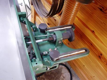

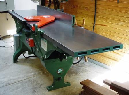

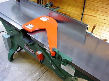

This machine was purchased new in 1980 from Northfield by a local lumber company near Columbus, Ohio. It was in pretty rough condition when I started restoration. I disassembled and stripped it to bare metal, reprimed and painted it. All of the fasteners have been replaced with stainless steel and all the electrics replaced. The new motor is a Baldor 5hp single phase with a GE size 2 starter. I have a new Byrd tool shelix helical carbide insert cutterhead on order along with all new bearings and seals. The tables were in good condition so I hand lapped them with diamond abrasive plates starting with 220 and working up to 1200. It is essentially a new machine. Northfield was kind enough to supply me with a set of new warning plates and logos to complete the restoration. The photos show it prior to installation of the new cutterhead. This was a labor of love. The machine is a joy to use. They truly just don't make them like they used to. The beauty of restoring a Northfield is that they can supply any part you may need. My restoration paint work is a bit different than originally supplied, because the factory sprays the assembled unit, but I masked and sprayed each piece completely disassembled. It's a nice touch since it allows me to show off all those stainless fasteners. The original manual appears to be hand typed and includes some handwritten notations from the manufacturer.
Northfield 16HD hand jointer
From my shop near completion of restoration
The rebuilt fence
The fence tilts 45 degrees in either direction.
Near completion of the restoration
You'll note that the cutterhead still hasn't been installed.
