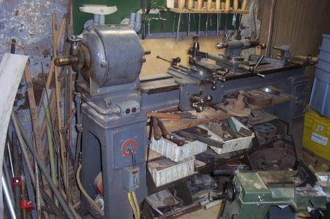

This machine has a four speed dial with the highest speed blocked by a pin, this has always intrigued me. It also has the carriage with compound, which I have also used to mount a router to for fluting. The tailstock has a cross slide capability for tapers. My brother, a patternmaker by trade and half owner of the machine, made patterns for the missing toolrests and machined them.
Unlike many of these lathes, this one has a flat bed, which I haven't seen often on these. It runs on 3-phase and is currently hooked up with a phase converter at my father's house. It will need to be moved soon and I will take clearer pictures then.

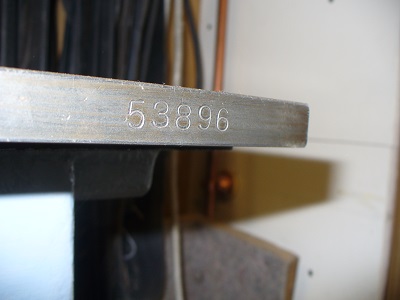

the image below with the number is from the right end of the lathe bed which I had never noticed until I cleaned this machine up last year. I had always thought that the serial number on the motor was the one for the lathe but I now believe that the motor and lathe had separate numbers. It is not common to even see a serial number on Blount products.
lathe at my father's cluttered shop

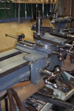

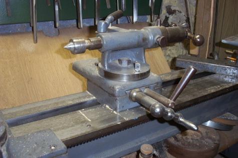

closeup of tailstock with livecenter my brother made

serial number

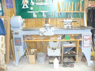

same machine repainted and at it's new home

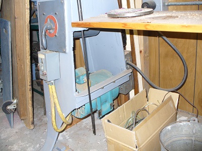

showing the position of the rotary phase converter
