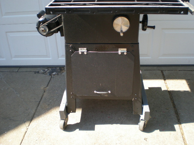

I purchased this saw at a yard sale in 2010 for $20.00. When I got it home, I repaired the arbor threads and installed a new blade. Even though the saw was in rough shape, it made very accurate cuts. In the summer of 2011, I decided to restore it and enclose the bottom to make it into more of a cabinet saw for blade and accessories. The door panels are made from 1/8" ABS plastic sheeting. I also made a wear plate for the fence out of ABS sheet plastic. The cover plate that shows the cut angle was in such bad shape that I couldn't save it. So I bought a $5.00 HF angle finder to dial in the blade. The last photo is the before picture.
