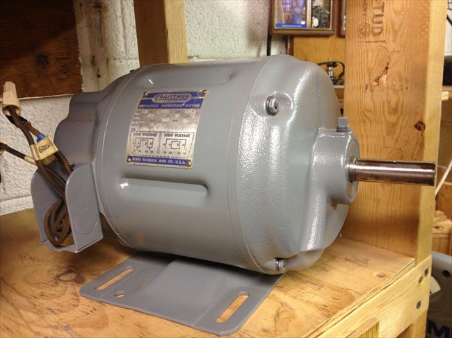

Purchased in 2007 from a fellow OWWMer in Ann Arbor Michigan.
Restored in 2010.
Missing the brush and junction box covers.
>>MOTOR<<
Craftsman/Leland Repulsion start Induction run motor.
¾" shaft.
Standard 6204 bearing on shaft end.
Special 6202 with 17mm bore (no longer made) on other end. This one is an SKF with removeable shield, so I flushed and repacked with Mobil Polyrex EM grease.
Primer is Krylon gray.
Top coat is Rustoleum Smoke Gray.
