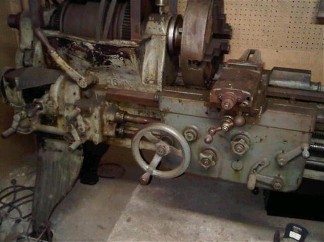

Purchased in fall 2012, from an auto shop owner on Lake Erie who had it for >10 years, but never got it running. Mechanically in good shape but covered in many layers of painter OVER top of dirt and shavings (a real mess to clean up).

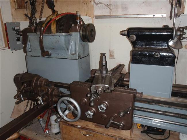

10" riser blocks give me about 30" swing over the cross-slide.

Original conditions in PO's shop

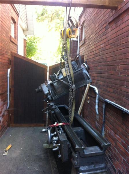

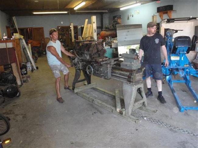

Moving the beast, hey, its only 4000 lbs
Partly set up - Risers in place, no motor yet.
