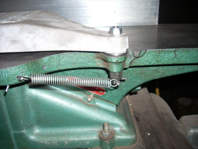

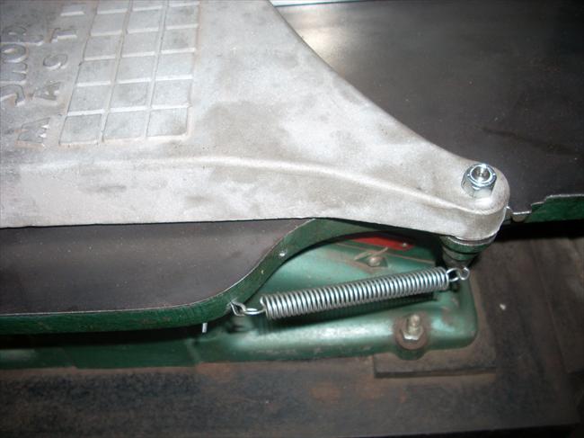

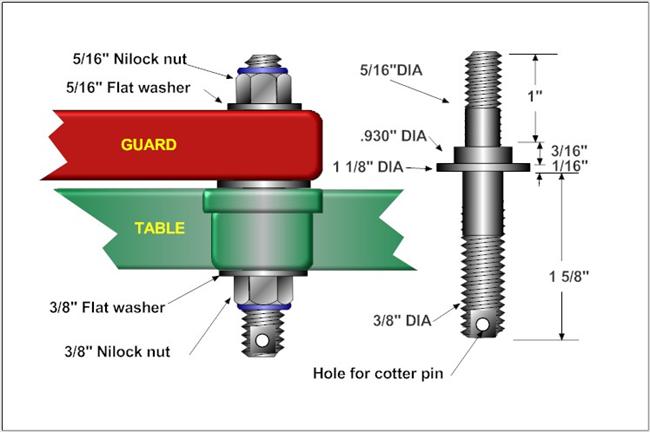

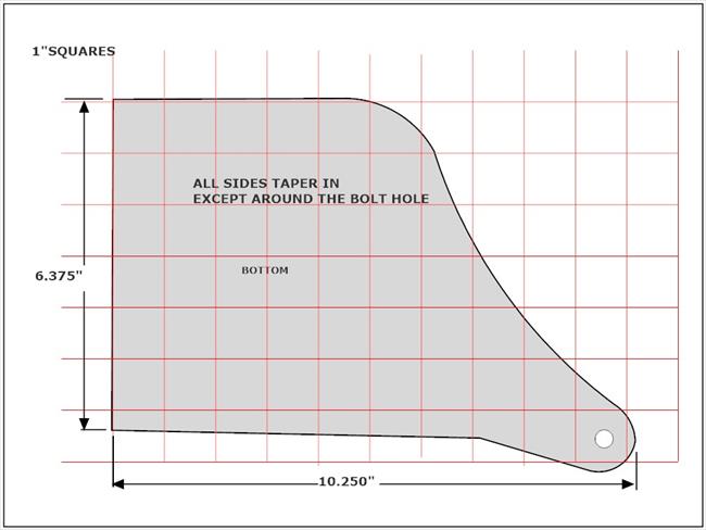

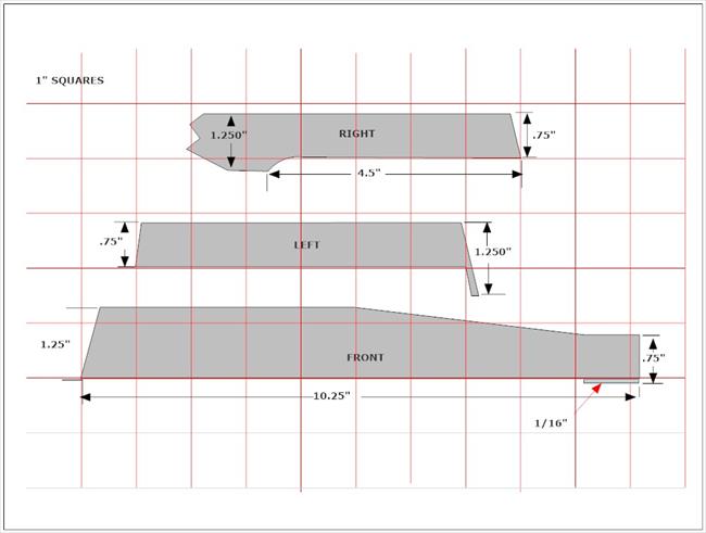

This is a good machine and I use it a lot, but the return spring on the guard broke and I couldn't find another so the pics will show what I came up with. I have a old Sheldon metal lathe so making the bolt was not a problem. Maybe it will give ideas to other members with the same problem. Added two drawings of the guard in case anyone has to build one.
Spring assembly
Another view
Drawing
bottom
right, left, front
