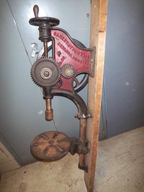

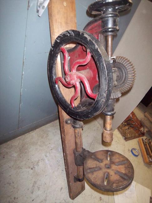

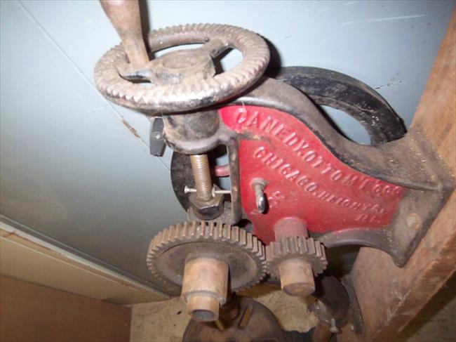

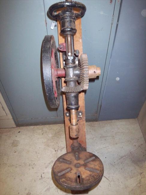

This drill has a 1/2" straight shank chuck. Quill travel is 3" with 26 turns of the top feed wheel. That wheel has 67 teeth that can be selected at one tooth per crank, two per crank or three per crank. There are 46 teeth on the primary crank shaft, 22 on the secondary crank and 30 on the quill. The crank handle is missing but could be mounted on either right side shaft. The flywheel is 13 1/2". It weighs 103 1/2 lbs. as pictured. The board does not appear to be original and the color shown is probably not original. In addition to the crank, the feed arm and pawl are missing. The right side casting reads "CANEDY.OTTO M'F'G.CO CHICAGO.HEIGHTS,ILL." and "No. 00".
Left side full view.
Left side detail showing hi and low speed crank positions.
Front full veiw.

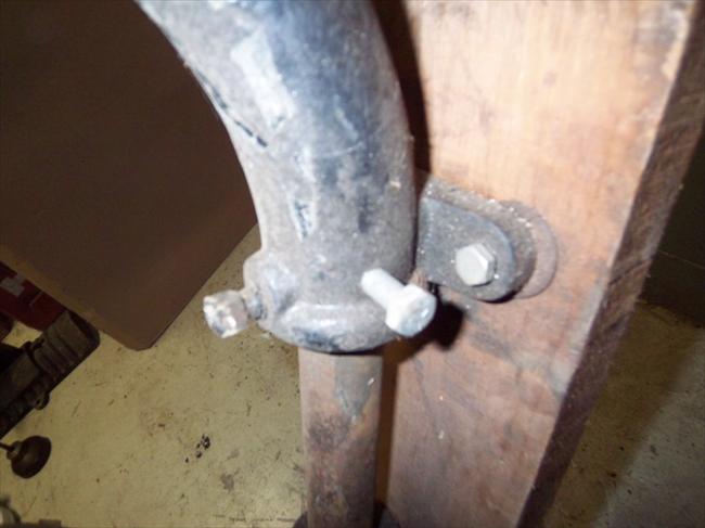

Left side detail showing replacement pin and missing feed arm position.
Detail of later bolt addtion.
