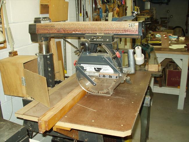

A yardsale find in the late '90s, included the Sears mobile base. In good shape except the paint on the arm shroud is a mess, PO told me he would roll it out from the garage to his driveway to work, and it got left out in the rain. It had starting problems when I bought it; disassembled the motor and found the centrifugal start switch (and everything else) packed with sawdust. A thorough cleaning and it's run fine ever since.

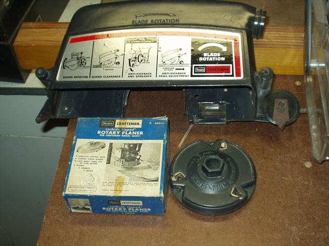

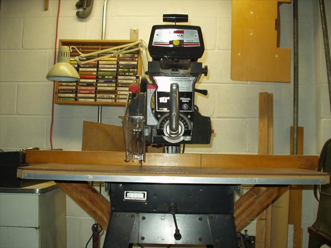

The original table top was shot, I built a new, larger one. The blade guard is a new one I got through the Emerson safety recall, but it's difficult to do bevel cuts with the new guard, I still use the original one for those.
Comments: Left side, new guard

Comments: front view

Comments: original guard and planer accessory
