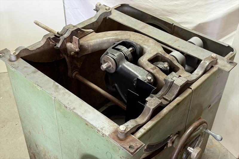

Partially disassembled for upgrading.
Both the top and the motor were removed to facilitate upgrades. No other operational components or assemblies have been loosened or removed.
The upgrades include 2 new bearings on the arbor shaft, the installation of a new flat poly-groove drive belt and pulley on the arbor shaft, and the planned change-out of the original 5HP-3PH motor for a 3HP-1PH motor.
The arbor shaft upgrade work is complete but neither the motor or the cast iron top has been reinstalled.
There saw was operational prior to beginning the upgrades. There is no known damage to any part or component. Everything required to reassemble the saw as an operating unit is included. All fasteners removed at the time of disassembly are present, bagged, and identified.
Refer to the attached PDF for a complete listing of all of the original components and many additional accessories which are included in this package.

The cabinet is fully assembled, with the all of the yokes and the tilting arbor assembly in-tact. Nothing mounted in the cabinet was removed or disassembled other than Motor/Motor Mounting Base and the Arbor Shaft assembly.
The Clean-out Access Panel/Door was sandblasted and painted.
Two motors are included, both the original 5HP-3PH, and intended replacement 3HP-1PH.
New bearings have been installed in the Arbor Shaft Assembly and that assembly has been re-installed.
After the original motor was removed, the Motor Mounting Base was also removed, sandblasted, primed, and reinstalled.
The Cabinet Saw is complete, including all pieces, parts, components, and fasteners.
Both the blade-tilt and the blade-height adjustment systems function freely, without binding, and with no ‘slop’ in the mechanisms.
In the cabinet photos, the cabinet may appear to have rusted areas, but that rust is only superficial/surface-rust. The Cabinet is sound and undamaged.
