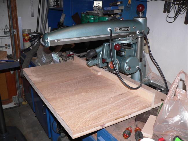

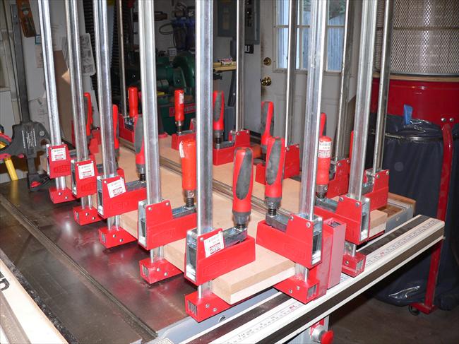

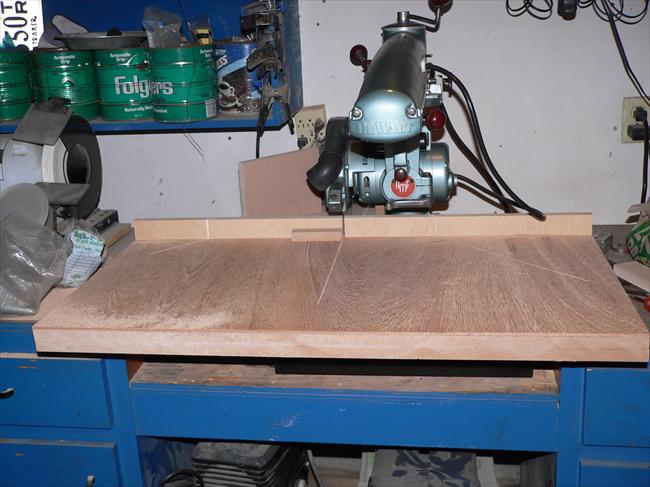

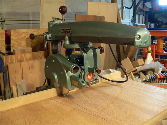

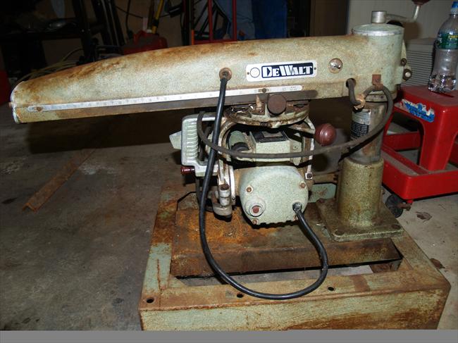

This machine came from NJ in less than stellar condition. It had the original paint and some serious rusting on the base. I went over the whole saw and replaced bearings in the motor along with the 4 bearings in the carriage. The table is made "Mr. Sawdust" style with 2 layers of MDF and 2 steel bars set in epoxy in the middle. It cuts very well.
DeWalt MBF, almost done

Saw as found
Brothers camera
Front view in its new spot
Panasonic Lumix fz-15
All cleaned up and pretty
Glueing up the table

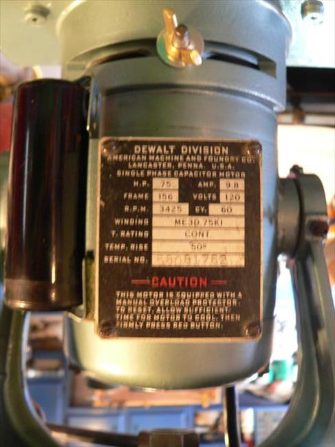

Motor Tag
