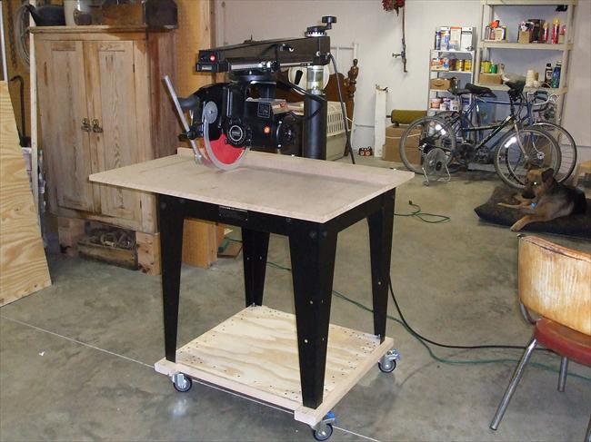

The saw was NOT aligned from the factory, in spite of what the owner's manual stated and I had to set all alignment adjustments except rollerhead bearings to arm tracks, base to column gibs, and crosscut travel parallel to arm tracks. I decided not to run the factory blade and installed a 44 tooth Diablo. I threw together a homemade mobile base for it. Started my first project using it today: rebuilding my deck. The saw runs and cuts smooooth as chicken lips, and I'm getting better accuracy out of it than my CMS. I love it.
Comments: "New" 1985 vintage Dewalt 7790 immediately after assembly and alignment on Aug 30, 2009.

Comments: The 7790, complete, aligned, mounted on a homemade mobile base, and ready to make sawdust. Smooooth machine!
Source: Tim Baker
