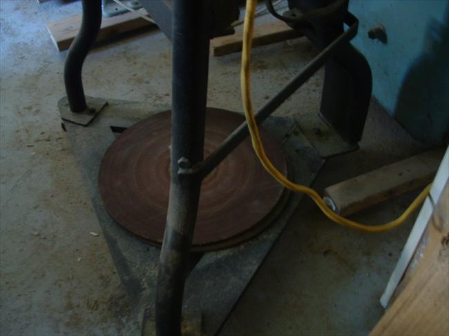

The machine was as described, the upper portion--motor, discs, table, etc--in very nice usuable condition, the original base in terrible unusable condition, the rear, hollow, leg broken, the original leg bracing broken, removed and replaced by fix that did not seem permanently suitable.
At the top I wired in a switch, made bushings for the internal friction drive fan, and made a hinged dust cover (which I have not seen in the available original Wonder literature but noticed a bracket probably original which seemed designed for same. On the bottom I drilled and tapped for a heavy plate to bridge the broken portions of the back leg and made a light but strong wooden bottom base to which I bolted the machine on leg flanges already in place and which stiffened up the assembly to an acceptable point.

I hope to remove the poor leg fix and replace it with a more sightly and stronger repair, though I believe the machine is strong enough now to be perfectly usable.

detail, showing wooden base with casters
R. Bernstein
