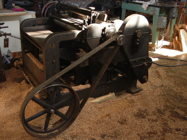

Acquired in a trade. This is an early direct motor drive model. It's main journals are 11" x 2 1/4" babbitt with self oiling boxes and micro adjust side clamping caps. In this case, the motor option requires attentive adjustment of the stator housing as the bearing wears. Motor was made by American. This one has been re-wound. It is not possible to drain the motor side bearing by gravity means with this drive option. Lower front right side feed roll adjustment requires removal of part of the spring link rods. Other than that, straight forward. Some wedge oilers a bit of a reach.
These are a truly amazing machine. Runs like a clock and treats the material like china.
More on this machine at: http://awwm.wordpress.com/american-no-444-30-planer/
Front view. Elevation handwheel and gears for moving the wedge in and out. Table rides on an incline and on two vertical guides. Feed engaging lever. This is a two speed machine.
owner

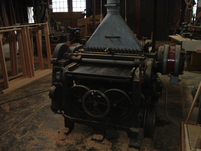

Hood down behind chipbreaker springs, belt guard for first feed reduction, metal for chains and third reduction.
owner

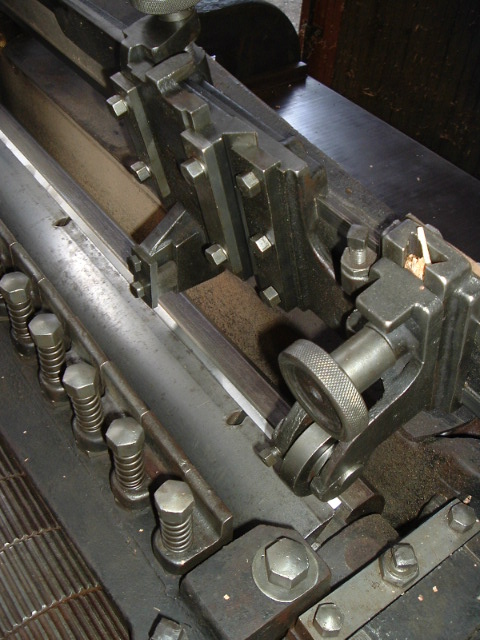

Sectional feed roll sections chipbreaker sections tension adjustments, feedroll pressure adjustments, chipbreaker to feedroll zero bearing adjustments. Knife gauge on jointing bar. Emergency oil cover on bearing cap which is side clamping.
owner

One of the four bearing micro adjustment screws, knife setting gauge, jointer, knife jack slots in head.
owner
