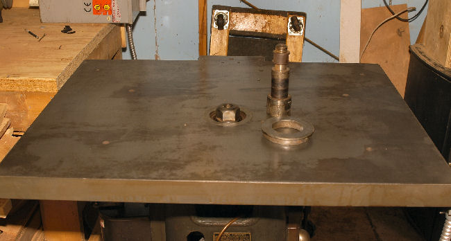

The notorious "Funky Table" so called because it lacks the Onsrud name and has a rear extension not seen on most other tables. I've only seen one other Onsrud shaper with this type table. This was the only flat table of three - all different.

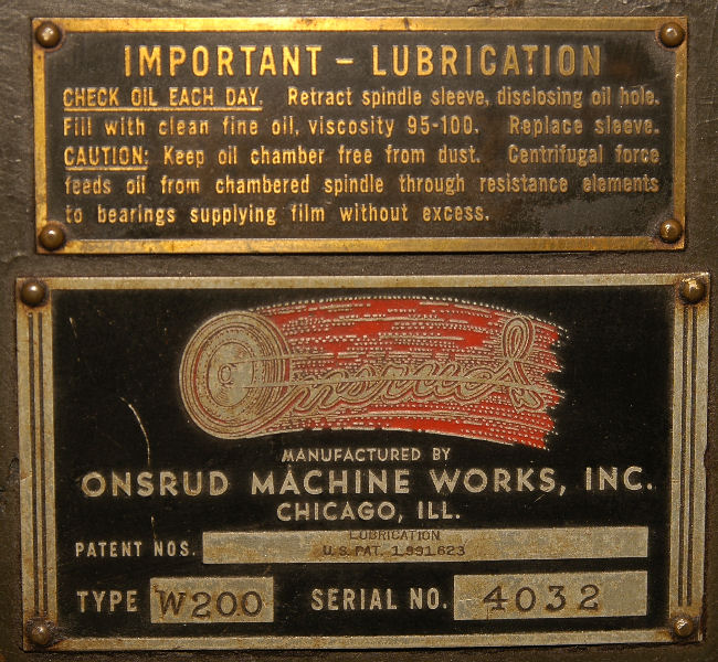

And what machine entry would be complete without the badge? One day I hope to find out what year this S/N is - that patent number should be useful for something, too. This is a terrific machine!
