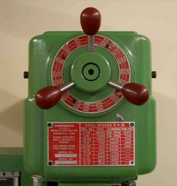

One feature of the restoration I'm really pleased with is the speed control of the VFD. Powermatic sold these drill presses with three different speed motors. An 1140 RPM motor corresponds to the middle band on the speed dial. I preprogrammed the VFD to run the motor at each of the RPMs indicated on the speed dial. This is controlled by a simple rotary selector switch on the front of the VFD enclosure. Just set the VFD with the rotary selector to produce the desired RPM and use the drill press speed dial to create the needed spindle RPM. The best of both worlds. I also added a toggle switch to the VFD that lets me reverse directions. The drill press and VFD are powered up by the Cutler Hammer push button on the front of the drill press via relay. In other words it turns on and off just like it always has. This is one of my favorite restorations and shop tools.

A VFD combined with variable speed pulleys offers a lot of capability.
Variable spped drives run true.
VFD programmed to match the three motor RPMs on the speed dial.
