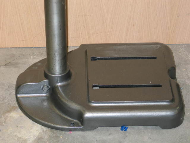

I got this in a multiple machine trade from another OWWM'er. I bead blasted all of the castings, and polished the column on a lathe. I installed new bearings throughout. I got the chuck dialed in to within .002" run out. It runs super quiet. I also filled the arc of shame with a spray welder, and resurfaced it on a flywheel grinding machine.
