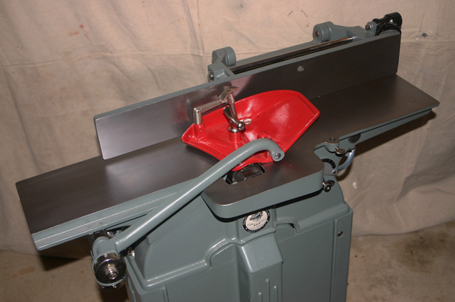

Found at local used machine store. Mostly complete, but subject to hard use and abuse. Has art deco cast iron base made only for 1939 models.
A fuller story of restoration can be found here:
http://www.owwm.org/viewtopic.php?t=47938
Color matched to original W-T green/gray. Black trim color and red guard as original. All hardware replated with nickel plate where original. Hole in front panel made with cutting torch repaired. Replaced generic motor with W/T 1/2 hp motor from another W-T machine. Replaced missing or broken parts with those from donor machine. These included depth-of-cut gauge; outfeed adj. hand wheel; thin strip hold down on guard; fence yoke; and fence protractor. New bearings throughout, new knives, new v-belt. Ready for another 70 years of service.
As restored
