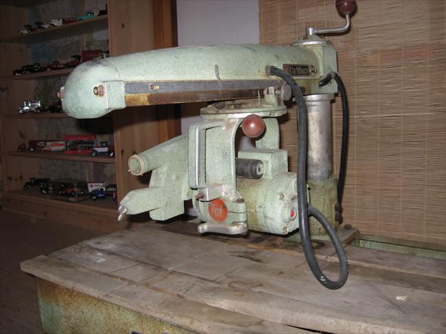

I have begun the restoration process on this great saw. I am the 3rd owner. My Dad bought the saw in the mid 60’s from a friend of his. I brought the saw home and plugged it in and ran like new. Even after having been stored outside under a tarp the last 12 years. I am very excited about this project. Restoration is 98% complete. New Mr. Sawdust Table with sacrificial Deck. Paint is not original color but it's pretty close. More brown than the original green. I used a Rust Oleum product called Stone Sienna. I took almost everything to bare metal, two coats primer, 4 coats Stone Sienna and 3 coats of a clear topcoat in a matte finish. All Rust Oleum products.
Comments: DeWalt GWI After
Source: Canon A560
Comments: DeWalt GWI Before
Source: Canon A560
