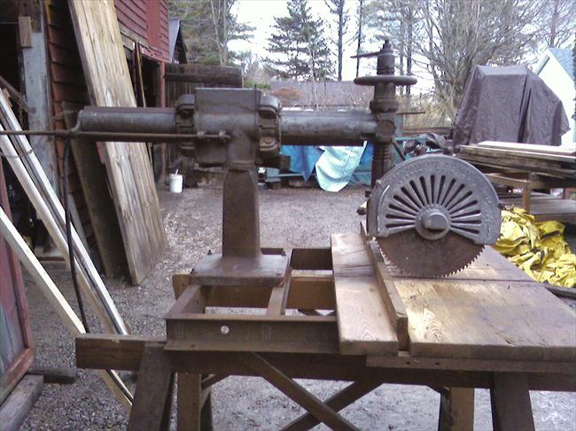

Found in a cattle barn in upstate NY near Canada.I belive this to be the first one seen in the wild.It
seems to be almost complete,missing is the cast iron ripping fence that attaches to the front of the steel sub frame.The saw has no repairs or broken parts.It will need to be taken apart for cleaning and painting.It has a 5 h.p.,220/440 volts,3 phase,direct drive Woods electric motor.The saw has 25"of travel,5 3/8" depth of cut,0 to 60 degrees left or right for angle cuts and will tilt to 60 degrees.
Comments: rightside view
Source: myself
