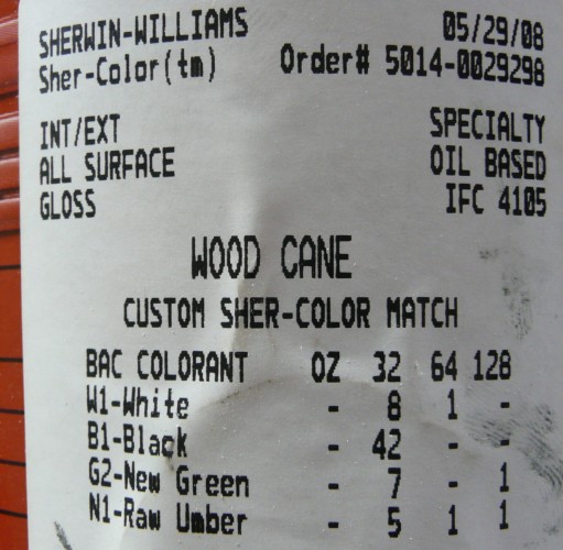

I picked this one up at a school auction . I'd guess it's about a 1950 vintage but I'm not sure. This poor thing was in really bad shape. I completely disassembled it, sandblasted, repainted & replaced all the bearings.
