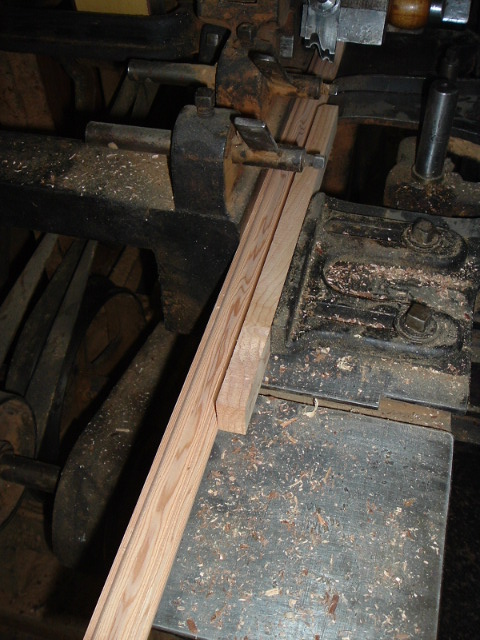

Acquired in 1987 from Whitehouse Crawford Co., Walla-Walla. This has been a dedicated sash machine for most of it's years. It has been stored the last ten years in favor of it's larger cousins the 2 1/2 and 3 1/2 which are heavier and more versatile. It is fast to set up. It's side head tilts for check rails. It has a somewhat weak feed works. There are no rollers in the table. Pitch can be a real nuisance. Table must be kept well waxed.
Machine running: http://www.youtube.com/watch?v=FcIgv5_1Xm0&feature=plcp
top head with slot head and tilting side head
