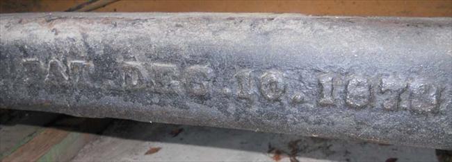

The machine has a Dec. 10, 1878 Patent Date on it.

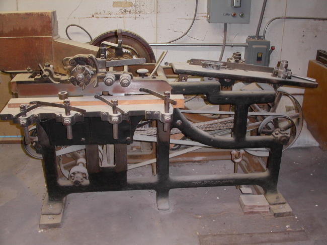

Sash Sticker - ad obtained by IRM
Duane Shephard photo

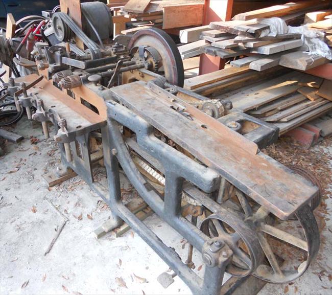

As obtained by Georgia Museum of Agriculture
Keith Rucker

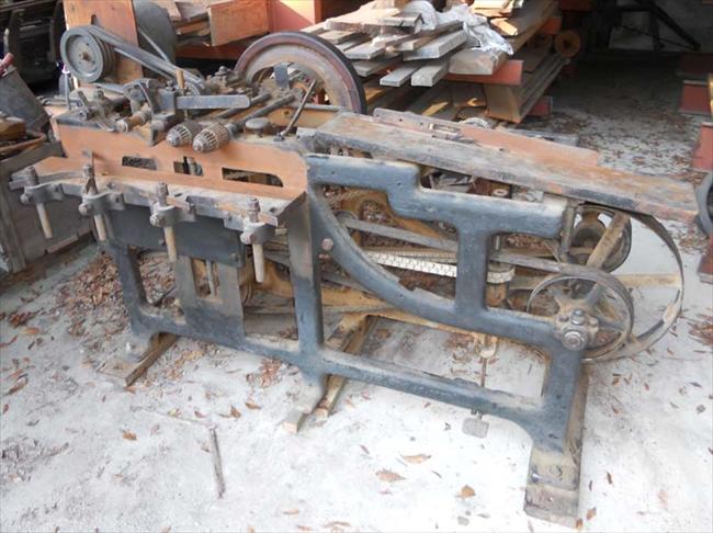

Another shot.

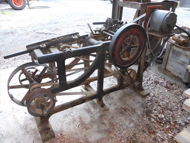

Back side of machine

Patent Date
