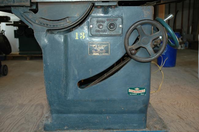

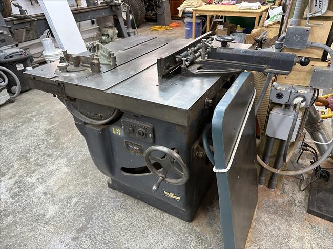

Comments: Main and 3' side table.

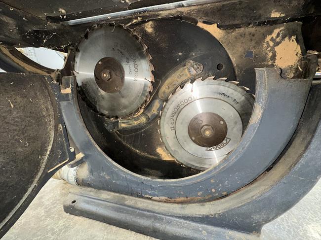

Comments: The money shot, two 16" Forrest Woodworkers

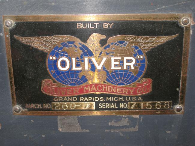

Comments: Original Badge!

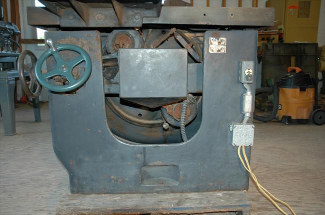

Comments: Machine tags from operator position; if it ain't "AL Young" its "Star Machinery" in these parts!
Source: Prior Owner
Comments: School Machines typically have a key lockout like this--I'll be replacing all of this in time. Also new handwheel from Rich's stash.
Source: Prior Owner

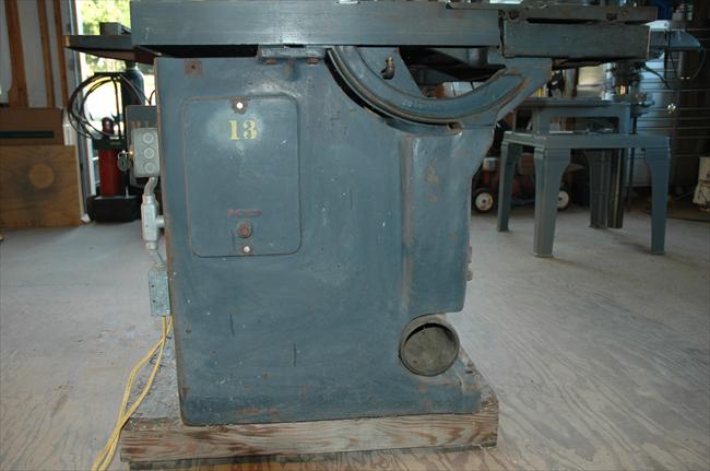

Comments: Outfeed side of the saw showing dust collector port; I believe its 5.5" OD and motor starter/reset switch
Source: Prior Owner
