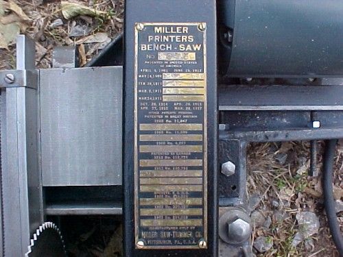

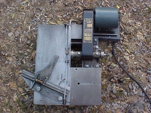

Bought off of Ebay for $10 (local seller). Missing side table fence, blade guard, and sharpening stone. Miller Saw-Trimmer Co. Pittsburg PA, USA. Earliest US patent May 18,1909. Last US patent on tag is March 27,1917 ,last Canada patent is 1918, Great Britain patent 1908 , Brevette,S.G.D.G. patent 1908. Machine # 975 (serial # or ?)on tag. Has a sliding table and holdtite attachment. Came with a Wagner Electric Corporation 1/4hp 1725rpm 220v motor switched to General Electric 1/4hp 1725rpm 115v motor. Uses a flat woven belt with the motor pulley needing a 1/2" spindle. Could use a 1/2hp motor. Will repaint it low gloss black in the spring if I can break 4 large screws free that hold the table/arbor assemby to the base.
Miller printers saw

Tag (on belt gaurd)

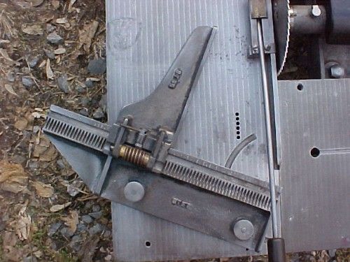

pivoting miter gauge
