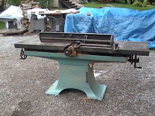

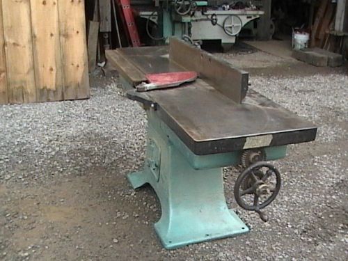

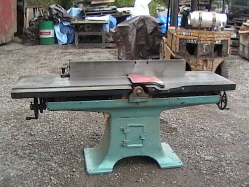

I acquired this jointer in a private sale on Long Island,NY.The old owner was second generation to use this machine.He stated that the machine was very accurate.They converted it from babbit to ball bearing.It has a four knife round clam shell type cutter
head.The motor is 5 h.p.,220 volts,3600 RPM's,3 phase,vee belt drive.The infeed table is 24" by 38",the outfeed table is 24" by 44" which includes a 4" rabbiting shelf.The fence
is 6 1/2" by 48" and tilts to 45 degrees.The jointer is in very good working condition.
front view

back view

view of the top and fence
