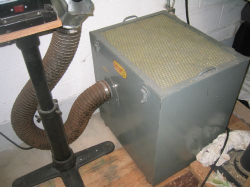

A Dustkop model 520 1/3hp cyclone metal dust collector (dumpster find) is spring clamped to the exhaust outlet on the right wheel. This dust collector is very handy.

Dustkop 520 metal dust collector
Canon S230 with flash in my basement shop
