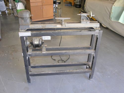

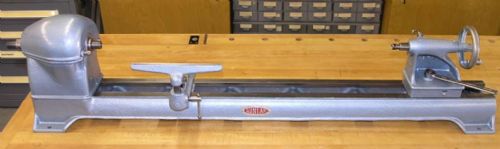

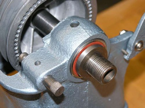

I bought this at a garage sale for $25. I trashed the stand as it was terribly unstable. The bronze spindle bushings were a bit loose so I decided to re-machine the headstock to accept sealed ball bearings. I selected a 6203-3/4 as it has the smallest O.D. and a 3/4 bore. These came from Accurate Bearing, a great outfit. I plan to install a 1/2 hp 3 phase motor and VFD for power.
Right from the garage sale
Finished lathe
Bearing detail
